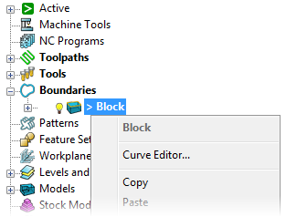

Use the individual Boundaries menu to manage and edit the selected boundary.
To display the menu, in the Explorer, right-click an individual boundary.
Block — The name of this menu and the name of the selected boundary.
Curve Editor — Click to display the Curve Editor tab, which enables you to create and edit boundaries. The assumption is that you extract curves from the model, by extracting curves at surface boundaries, before modifying the curve to create the exact boundary you need.
