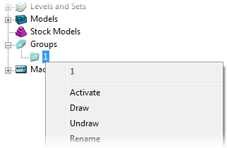

Use the individual Group menu to manage and edit the selected group.
To display the menu, in the Explorer, right-click an individual group entity.
1 — The name of this menu and is the name of the selected group.
Activate — When selected, activates this group and de-activates any currently active group. When deselected, de-activates this group.
Draw — Selected to display all the entities in this group. This is the same as selecting
Undraw — Select to "hide" the entities in this group so they are not displayed. This is the same as selecting
Rename — Select to rename the entity.
Properties — Select to display an Information dialog which displays the extents of the group and the group name.
Edit — Select to copy or transform the group.
Copy as NC Program — Select to create an NC program containing the toolpaths in the group. The NC program has the same name as the group.
Create Individual NC Programs — Select to create an NC program for each toolpath in the group. The NC programs have the same name as the toolpaths.
Delete Group — Select to delete the group. It does not delete the entities in the group, just the association between them.
