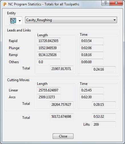

You can display the length and time values for all of the leads, links, and cutting moves, as well as the number of lifts in the selected NC Program.
To display the NC Program statistics:
The NC Program Statistics dialog is displayed.
This dialog contains the following:
Toolpath / NC Program list— Select whether the statistics are displayed for the selected toolpath or NC program.
or NC program
you are interested in. By default, the selected toolpath or NC program is the one you used to display the dialog, but you can change it.Changing either of these options automatically updates the statistics.
