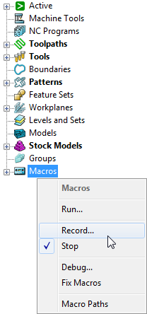

  2. From the Macros context menu, select Record.
  3. Browse to pmill4 folder in your Home area. In the Select Record Macro File dialog, enter pmuser in the File name box, and click Save. If you are asked whether you want to overwrite the existing file, select Yes.

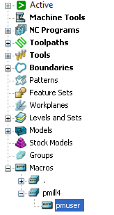

  5. From the Macros context menu, select Stop to finish recording.
  6. Expand the Macros node. The pmuser.mac macro is added under pmill4.
  7. Close and then restart PowerMill to check that the settings from the pmuser macro are activated.
