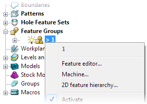

Use the individual Feature Group menu to manage and edit the selected feature group.
To display the menu, in the Explorer, right-click an individual Feature Group.
1 — This is the name of this menu and the name of the selected feature group.
Feature editor — Select to display the Feature Editor tab.
Machine — Select to display the Strategy Selector dialog.
2D feature hierarchy — Select to display the 2D Feature Hierarchy dialog.
Activate — When selected, activates this feature group and de-activates any currently active feature group. When deselected, de-activates this feature group.
Activate Workplane — Select to activate the workplane used to create this feature group.
