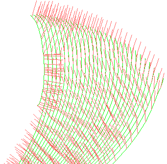

- Tool Axes — Draws the axis of the tool at each toolpath point so that you can visualise the changing tool orientation:
- Contact Normals — Draws the toolpath contact normals at each toolpath point in red.

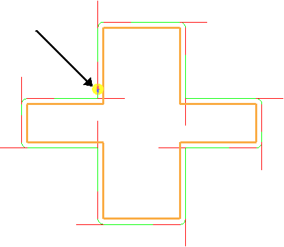

- Compensated Toolpath — Draws the toolpath showing full radius or wear compensated toolpath.
