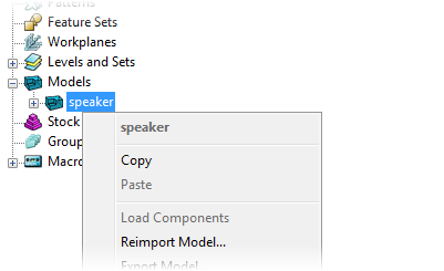

Use the individual Model menu to manage and edit the selected model.
To display the menu, in the Explorer, right-click an individual model.
speaker — The name of the model.
