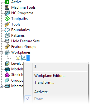

Use the individual Workplane menu to manage and edit the selected workplane.
To display the menu, in the Explorer, right-click an individual workplane.
1 — The name of the selected workplane.
Workplane Editor — Select to edit the location and orientation of the workplane using the Workplane Editor tab.
Transform — Select to display the Workplane Transform tab which enables you to create a new workplane by moving, rotating, or mirroring the selected workplane.
Activate — When selected, activates this workplane and de-activates any currently active workplane. When deselected, de-activates this workplane.
Draw — When selected, displays the workplane. Deselect to "hide" it. This option toggles between
