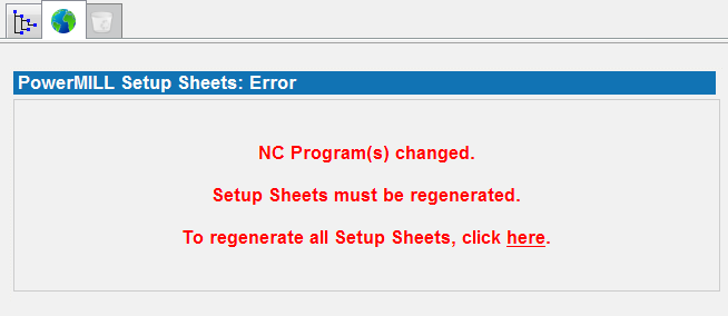

If you've modified an NC program after previewing the setup sheets (for example, removed or added a toolpath, re-written a program and so on), PowerMill creates an HTML page with a warning that the setup sheets are out of date.
Clicking on the provided link updates the setup sheets to reflect the NC program change.
