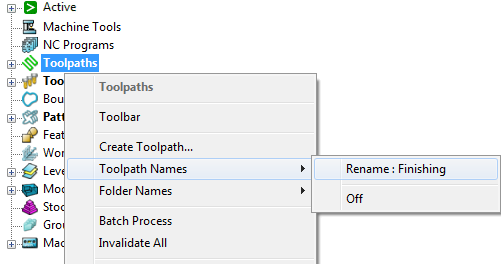

Stock Model Names — Select to define the template used for all new stock models.
This controls the naming convention used when creating multiple entities. This is described for toolpaths, but all entities work in the same way.
Enter the name of the template prefix you want to insert, in this case Finishing, and then click
. This displays Toolpath Names > Rename: Finishing on the menu, so that you can easily see what the prefix is. All new toolpaths now use this prefix (so, the next toolpath you create will be Finishing1, the one after that Finishing2, and so on).
Toolpath Names > Rename: None — When displayed, does not add a prefix to all new toolpath names.
Toolpath Names > Rename: Finishing — When displayed, adds a prefix of Finishing to all new toolpath names.
