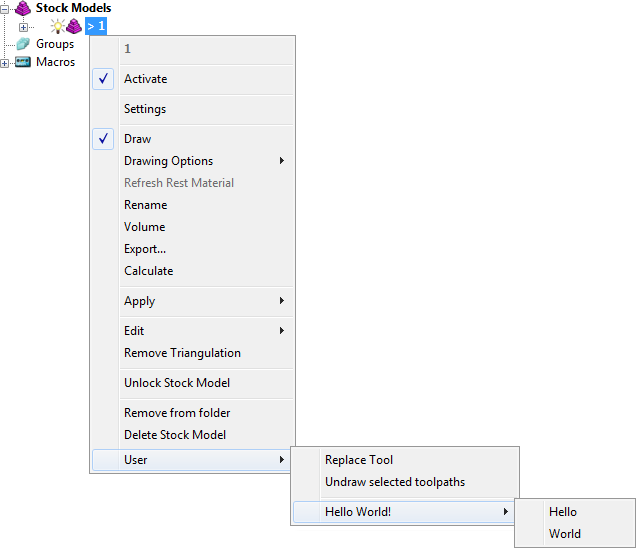

To add spaces to the menu, add the <spacer/> tag to the XML code. To add submenus, include the submenu name in a <menupage> tag.
For example, to create this User menu and submenu called "Hello World!" with relevant spaces:
The code in the stockmodel.xml file is:
<?xml version="1.0" ?>
	<menupage>
		<button label="Replace Tool"
		command='EDIT TOOLPATH "%s" REPLACE_TOOL ;'
		multiple_selection="allowed"/>
		<button label="Undraw selected toolpaths"
		command='MACRO d:/temp/test.mac "%s"'
	<spacer/>
	<menupage label="Hello World!">
		<button command='PRINT "HELLO"' label="Hello"/>
		<button command='PRINT "WORLD"' label="World"/>
	</menupage>
</menupage>
