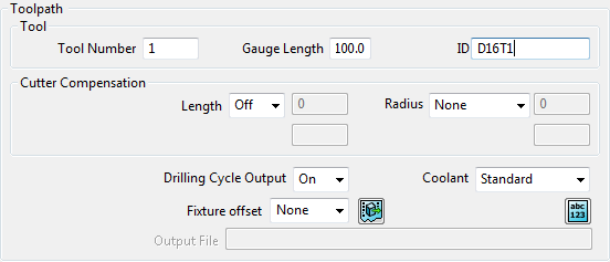

Selected Toolpath information
The bottom portion of the NC Program dialog enables you to display and change the settings for each toolpath in the NC program. To display a toolpath's settings, select the toolpath from the Toolpath list.

Tool Number — Enter the tool number used by the toolpath. By default this is the same as the Tool Number on the Tip tab of the Tool dialog. This is added to the cut file.
Gauge Length — Enter the gauge length. By default this is the same as the Gauge Length on the Holder tab of the Tool dialog. The value is the total length of the tool assembly that protrudes from the spindle when mounted in the machine tool (the length from the tip of the tool to the top of the holder).
Note: If you edit this value then, like the tool number, in the NC Program table, the value it is preceded with *. This value is used for multi-axis calculation.
ID — Enter the name of the tool. By default this is the same as the Cutting data tab of the Tool dialog, and is added to the cut file. If you export a tool to a tool database you export the Tool ID and not the Name (on the Tip tab of the Tool dialog). By default the Tool ID is the same as the Name. This is added to the cut file.
Cutter Compensation — For most controls, except the Heidenhain, you need to enter the actual value used for length and radius compensation into the machine tool. To do so, enter the values into a register which is accessed by a number in the NC program.
For example, suppose you require a tool radius offset of 0.2 in the first toolpath and 0.4 in the second toolpath and set the radius offset number to 31 in the first toolpath and 32 in the second toolpath, the NC program file contains the codes G41 ... D31 in the first toolpath and G41 ... D32 in the second. Then type 0.2 into register 31 and 0.4 into register 32 and the values 0.2 and 0.4 will be used for the first and second toolpaths respectively.
Most people use the same number for the length offset number, the radius offset number, and the tool number. For example they expect to see T5, H5, and D5 in the same toolpath. Alternatively the radius offset number may have a fixed connection with the tool number. For example, if the tool number is 5 the radius offset number is 35, if the tool number is 7 the offset is 37. This can be easily taken care of by the postprocessor.
Occasionally however it is not possible to do this, so PowerMill has the ability to change the numbers if this is really required, but the default numbers are usually correct, and the numbers are used only if length or radius compensation is used.
Length — Select the type of cutter length compensation on the machine tool controller. The tool length used in PowerMill remains unchanged.
Note: This affects only files postprocessed for the Heidenhain control.
Compensation length — Enter the tool length, by default it is the tool entity length. This enables you to alter the length of the tool in the NC toolpath.
Length Offset Number — Enter the offset register number, used on the machine tool controller, to store length offset value. This is usually the same as the tool number and is useful when the default numbers are not correct.
Radius — Select the type of cutter radius compensation on the machine tool controller. The tool radius used in PowerMill remains unchanged.This enables you to offset a toolpath at the machine controller by an amount stored in a specific offset register.

Compensation radius — Enter the tool radius, by default it is the tool entity radius. This enables you to alter the radius of the tool in the NC toolpath.
Radius Offset number — Enter the offset register number, used on the machine tool, to store radius offset value. This is usually the same as the tool number and is useful when the default numbers are not correct.
Drilling Cycle Output list — Select Yes to save drilling cycles as canned cycles.
Coolant — Select a coolant option to apply to the selected toolpath.

Fixture offset list — Select a fixture offset to apply to the selected toolpath. To create or edit a fixture offset, click . You can also create a fixture offset by entering its name in the Fixture offset list.
Fixture offset — Click to display the Fixture offset tab on the Notes for NC Program dialog. This tab enables you create and edit fixture offsets.
Add Commands — Click to display the NC Program Commands/Comments dialog. The dialog enables you to specify commands and comments that are inserted into the NC program.
Output File — Specify the naming convention for the output files. You can enter variables into the filename which are resolved when you write the NC program.
