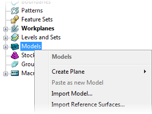

Use the Models menu to import, edit, and manage models in the current project.
To display the menu, in the Explorer, right-click Models.
Models — The name of this menu.
Create Plane — Select to create a plane.
to create the plane
Paste as New Model — Select to paste the entities on the clipboard into a new model.
Import Model — Select to open an existing model. This displays the standard Open dialog. Move to the correct directory and then select the model you want.
Import Reference Surfaces — Select to import a model containing reference surfaces which are never considered for machining or collision checking.
