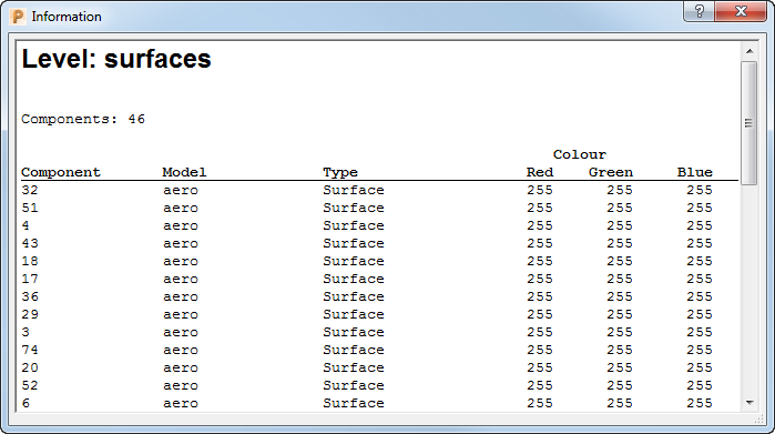

To display information about Level or Set components
Use the Properties item to display information about the components used in the selected Level or Set.
To display component information for a Level or Set:
  1. Select the appropriate Level or Set from the list on the Model tab > Levels and Sets panel.
    The selected Level or Set is activated.
  2. Click Model tab > Levels and Sets panel > Properties to display the Information dialog:
