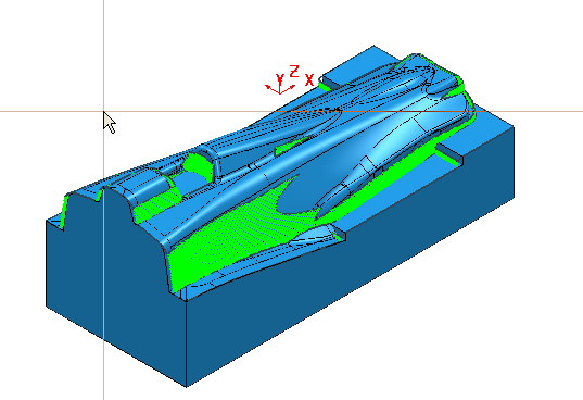

Use the options on the View tab > Cursor panel to specify how to display the cursor. The original cursor is always displayed.
Cross Hair — When selected, a cross hair cursor is visible on the screen. Ctrl+H is a short cut for this operation.
Tool — When selected, the current tool cursor is visible on the screen. Ctrl+T is a short cut for this operation. Use this option to perform a visual check as to the accessibility of a tool onto the part.
Tip — When selected, the tool cursor has the tip of the tool at the central cursor location.
Centre — When selected, the tool cursor has the centre of the tool at the central cursor location.
