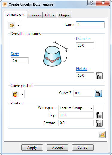

Specifying Dimensions for a Freeform Boss feature
Name — Enter a name for the feature.
Creation mode — Choose an option to specify how the features are created. Select:
Diameter — Enter the diameter of the feature.
Draft — Enter the draft angle of the feature. This is an angle incorporated into a wall of a mold, so the opening of the cavity is wider than the base, which allows for easier ejection of the part.
Height — Enter the height of the feature.
Curve position —Choose an option to specify the position of the profile curve on the feature. When you have specified a Draft angle, the draft is applied from the profile curve position.
Curve Z — Enter a value to specify the height of the profile curve along the Z axis. If you have specified a Draft angle, it is applied by offsetting the curve from this height.
Workspace — Select which workspace you are working in:
Top — Enter a value to specify the position of top of the feature.
Bottom — Enter a value to specify the position of the bottom of the feature.
Unlocked — When displayed, you can edit the value.
Locked — When displayed, you cannot edit the value.
Reset — Click to reset the feature creation parameters to their default values.
