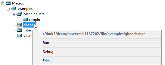

When you run a macro, the commands recorded in the macro file are executed.
  1. Expand Macros, and select the macro you want to run.
  2. From the individual macro menu, select Run.
You can also run a macro by double-clicking its name in the Explorer.
