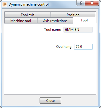

The Tool tab on the Dynamic machine control mode dialog enables you to edit the tool you are using.
This tab contains the following:
- Tool name — The name of the tool.
- Overhang — Enter a value to edit the overhang of the tool assembly. Entering a value overrides the overhang value specified on the Holder tab of the Tool dialog.
