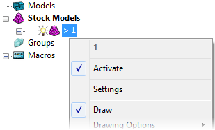

Individual Stock Model menu
Use the individual Stock Model menu to manage and edit the selected stock material.
To display the menu, in the Explorer, right-click an individual stock model.
1 — The name of this menu and the name of the selected stock model.
Activate — When selected, activates this stock model and de-activates any currently active stock model. When deselected, de-activates this stock model.
Settings — Select to display the Stock Model dialog where you can edit the currently active stock model parameters.
Draw — When selected, displays the stock model. Deselect to "hide" it. This option toggles between and .
Drawing Options — Options to determine how to display the stock model.
Refresh Rest Material — Select to refresh the displays of the rest material. This option is only required when you change the model, or the Rest thickness.
Rename — Select to rename the entity.
Volume — Select to display the volume of the active state of the stock model in an Information dialog.
Export — Select to display the Save Stock Model dialog which enables you to save the current active state of the stock model. Use the dialog to browse to the correct location and save the stock model as a *.stkmd file.
Note: This saves the current active state of a stock model into a new stock model as a single state.
Calculate — Select to calculate the stock model. By default, PowerMill creates a batch rest stock model which is calculated when you select this option.
Apply — Select to add a block, toolpath, or tool to the stock model.
Edit — Select to display the editing options.
Remove Triangulation — Select to remove the stock model triangulation from disc and so substantially reduces the size of the project.
If you do not select this option, PowerMill saves the stock model triangulation with the stock model to prevent recalculation.
Unlock Stock Model — Select to unlock the stock model for editing and overrides all locks on the stock model. This invalidates all references to the stock model.
Remove from Folder — Select to remove the stock model from the current folder.
This example uses feature groups, but all other entities work in the same way. It converts this:
For more information see Folders.
Delete Stock Model — Select to delete the stock model.
