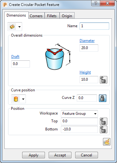

Name — Enter a name for the feature.
Creation mode — Choose an option to specify how the features are created. Select:
Single creation to create a single feature.
Curve creation to detect circular or quadrilateral curves and create an appropriate feature for each selected curve.
Multiple creation to create identical single features at every keypoint of each selected curve.
Diameter — Enter the diameter of the feature.
Draft — Enter the draft angle of the feature. This is an angle incorporated into a wall of a mold, so the opening of the cavity is wider than the base, which allows for easier ejection of the part.
Height — Enter the height of the feature.
Curve position —Choose an option to specify the position of the profile curve on the feature. When you have specified a Draft angle, the draft is applied from the profile curve position.
Top — Sets the profile curve at the top of the feature.
Bottom — Sets the profile curve at the bottom of the feature.Curve Z — Enter a value to specify the height of the profile curve along the Z axis. If you have specified a Draft angle, it is applied by offsetting the curve from this height.
Workspace — Select which workspace you are working in:
Top — Enter a value to specify the position of top of the feature.
Bottom — Enter a value to specify the position of the bottom of the feature.
Unlocked — When displayed, you can edit the value.
Locked — When displayed, you cannot edit the value.
Reset — Click to reset the feature creation parameters to their default values.
