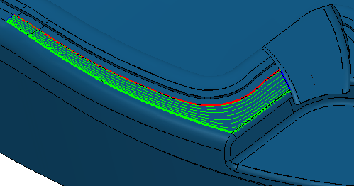

The Flowline Finishing strategy is a 5-axis, multi-surface strategy, which creates a toolpath between two curves, called drive curves, by smoothly blending between them. Additional limiting curves may be necessary to fully define the machining area. The curves must lie on a surface (or surfaces).
This strategy enables you to machine multiple surfaces independently of their surface parameterisation. It is typically used on complex fillets or gently curved surfaces.
