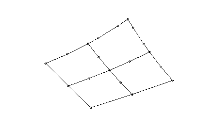

PowerShape creates an initial network of laterals and longitudinals based on the selected wireframe.
Consider the following wireframe:
The initial network for this wireframe is given below:

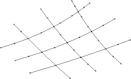

PowerShape then checks that each point lies at the junction of a lateral and longitudinal, and adds extra surface points and curves as required. How PowerShape does this depends on the edge matching option you select. You can choose from the following options:
If the spans have the same number of points, then the new curves pass through the corresponding points. No new points are added to the surface.

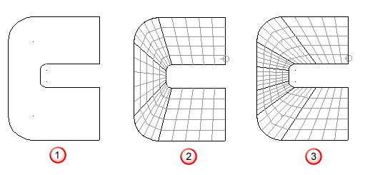

PowerShape checks points similar to the Arc Length option, except the tangent directions at the points are compared.
The effect is that new curves follow features such as corners, instead of being regularly spaced between the given wireframe.
The following images show the original wireframe
, the surfaces created using the tangent direction
, and arc length options
. With the tangent direction option, the points are matched where the tangent directions are equal.

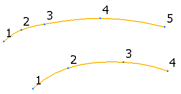

If a point lies at x percent along a span, then PowerShape checks if points lie at approximately x percent along the corresponding spans.
Select Repoint to redistribute the points within each span, so that the spans are approximately the same shape. Points are also added so that each curve has the same number of points as the curve with the most points.
For example, consider the following:
If the spans have different numbers of guide curves, the surface is created using the default Arc Length option.
