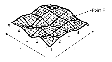

The values of t and u uniquely define a point, p, on the surface. Thus, point p can be defined by 3D world space coordinates (x, y, z) or by 2D parameter space coordinates (t, u). In the figure below, the 2D parameter space coordinates of p are (3.5, 2.75).
World coordinates are not guaranteed to lie on the surface, whereas parameter space coordinates must, by definition, lie on the surface (the third dimension is the surface). Curves used as part of trim boundaries of surfaces must lie exactly on the surface being trimmed, and so pcurves are defined within the 2D parameter space of a surface. They cannot therefore be operated on in quite the same way as other curves (for example, they cannot be dragged off a surface) and a special editor is provided to manipulate them.
