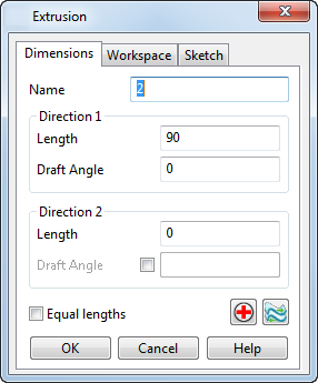

Double-click an extruded surface, and use the tabs of the Revolution dialog to edit it:
Use this tab to specify the dimensions of the extruded surface:
When you enter a value, the model updates dynamically to reflect the change.
to check that the draft angle is constant.
to
Reverse direction. This reverses the surface so the outside of the surface becomes the inside, and the inside becomes the outside.
Use this tab to edit the workspace options for the surface of revolution, in the same way as the Primitive Surface dialog - Workspace tab, except for the following unique options:
— This makes the Z axis of the workplane perpendicular to the plane in which the base curve lies. If the base curve is non-planar then the plane of best fit is calculated.
Use this tab in the same way as the Sketch tab on the Revolution dialog.
