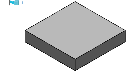

  1. Create a solid block.
    It is automatically added to the solid feature tree. The tree is hidden by default.
  2. Click Solid Tools tab > State panel > Explorer to display the solid tree in the Explorer window.

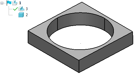

  3. Add a cut feature to the solid.
    The cut feature is displayed in the tree; the block at the bottom of the tree to show that the solid was created from a primitive block.
    The features are shown in chronological order in the tree. The most recent one applied is shown at the top and the earliest at the bottom.

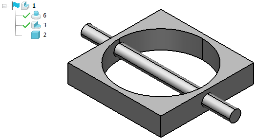

  4. Add a Boss to the solid.
    The boss feature appears above the cut feature.
