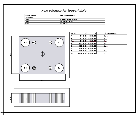

You can automatically create detail drawings of hole schedules from an assembly. You can create hole schedules for a mold base design like the one below:
A drawing is created for each plate in the assembly, containing:
You can customize the drawings using the template model called component_drawing_template.psmodel.
