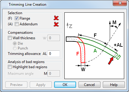

    The Trimming Line Creation dialog is displayed:
  3. Use the options in the dialog to create the trimming line:
    Selection
    • Flange — Select the flange surface (F). On the model below, this surface is indicated by . If the flange surface contains holes, the trimming lines of these holes are created as composite curves.
    • Addendum — Select the addendum surface (A). On the model below, this surface is indicated by .
    Compensations
    The values set in this section are incorporated into the calculation of the Trimline:
    • Wall thickness — Specifies the thickness of the flange. Select this option to use the thickness (W) when calculating the Trimline.
    • Die — Select this option to apply the wall thickness when creating a die.
    • Punch — Select this option to apply the wall thickness when creating a punch.
    • Trimming Allowance — Additional allowance to ensure that there is sufficient metal to create the required flange surface.
    Analysis of bad regions
    • Highlight bad regions — Select this option to highlight trim lines that are on a slope that is too steep. The slope of the addendum surface where the Trimline is created should be as gentle as possible.
    • Maximum of good angle — If Highlight bad region is selected, you can enter an angle. Any Trimline on a slope steeper than this angle is highlighted.
