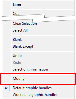

- Right-click one of the selected lines, and select Modify.

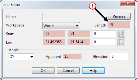

The Line Editor dialog is displayed. It is similar to that of editing a single line, with the following differences:
— The properties that differ between the selected lines are highlighted in pink.
— The range of values is displayed when you hover the cursor over a property.
