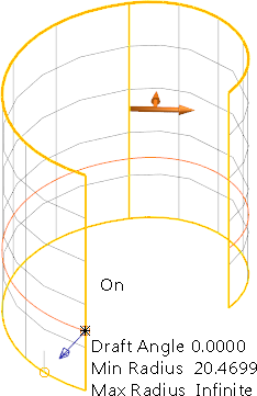

  4. Left-click on a position on the selected surface.
    By default, the surface normal arrow is displayed, and the draft angle and curvature values of the position are displayed below the cursor:
  5. Select File > Options > Application Options > Tools > Analysis, and use the Surface Analysis page to specify the data that is displayed.
  6. Drag the cursor across the surface to display data at different positions.
