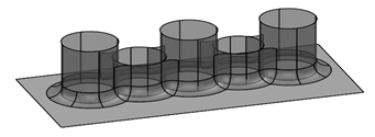

You can create fillet surfaces between sets of surfaces as follows:
- Along creases of surfaces.
- Between two lists of surfaces.
- Between surfaces and a 3D curve.
- A variable fillet between curves and surfaces.
To create a fillet surface:
- Click Surface tab > Manufacture panel > Fillet.

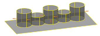

- Select at least two surfaces in your model.
The surface normal arrows of the selected surfaces are displayed. In the example shown below, all the surfaces are selected:

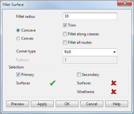

- Use the
Fillet surface dialog to provide initial data to create a fillet surface:
- Fillet radius — Enter the nominal radius of the fillet. Generally, set the radius to the smallest radius on the fillet. If the fillet runs around a corner, try a radius approximately equal to the fillet radius in the corner.
- Concave/Convex — Determines how the fillet is created between the two surfaces.

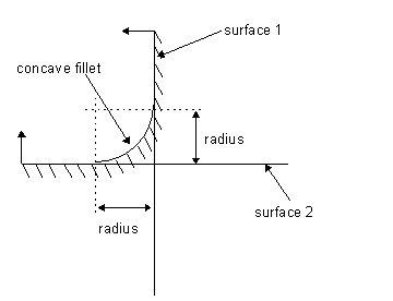

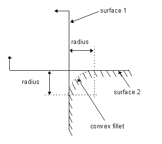

A fillet produced between two surfaces depends on:
- whether
Concave or
Convex is selected
- the direction of the surface normals on both surfaces
The example below shows a fillet solution between two surfaces using the
Concave option. The arrows pointing out from the surfaces indicate the surface normals.
Convex option. The arrows pointing out from the surfaces indicate the surface normals.

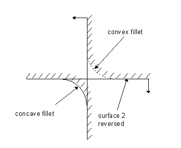

To obtain fillets in the bottom left and top right, one of the surfaces must be reversed, as shown in the example below. If you wish to change the direction of the surface normal of a surface, click the surface normal arrow.
Note: You should always keep the surface normal pointing out from the material. This ensures surfaces are correctly combined into solids.
Therefore, for any two surfaces, four possible fillet solutions can be obtained.
- Trim — Select this option to trim surfaces to the fillet surface when the fillet is generated. If deselected, you can still generate the pcurves and not the trim boundaries by turning on the
Keep pcurves generated by filleting option on the
Surfaces page of the
Options dialog (this dialog is displayed by selecting File > Options > Application Options).
For further details on pcurves and trim boundaries, see
Trimming surfaces.
- Fillet along creases — Select this option to fillet along creases in the selected surfaces.
- Fillet all routes — Select this option to create fillets along all the fillet routes between the selected surfaces.

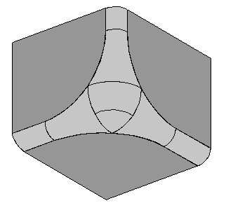

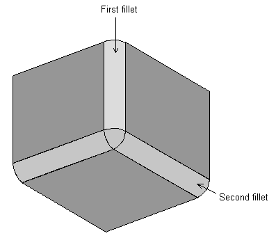

- Corner Type — Select an option to specify a corner type for the fillets:
Roll — Creates a round corner.
Mitre — Creates a sharp corner.
Round — This uses the
Fullness value to make rounder corner fillets with branches.
When you click
OK or
Cancel on the
Select Fillet Route dialog,
PowerShape searches for any corner fillets as shown below.
It makes them rounder using the
Fullness value.
- Selection — You can add objects to either the primary or secondary selections. The primary selection can only contain surfaces, whereas the secondary selection can contain either a set of surfaces or a single wireframe object.

To add objects to a selection, select the appropriate selection toggle (Primary or
Secondary) and select the objects. You can add more objects to a selection by pressing the Control key and selecting the objects. Surfaces in the primary selection are coloured differently to those in the secondary.
Note: You can select objects before displaying this dialog. If you select a set of surfaces and then display the dialog, the
Selection toggle changes to
Secondary and waits for you to add the secondary list of objects if any. If you select a wireframe before displaying the dialog, you are expected to enter the primary selection of surfaces.
- Preview — Displays the calculated fillet routes using the current settings in the dialog. You can continue to change the settings in the dialog until you are satisfied with the previewed fillet routes.
Note: When creating a fillet between a set of surfaces and a wireframe, the fillet surface is displayed.
- Apply — Creates the selected fillets and leaves the dialog open.
- OK — If the
Fillet all routes option is selected, this creates fillets along all the fillet routes. If the option is deselected, this calculates the fillet routes, removes the
Fillet dialog and displays the
Select Fillet Route dialog. For further details on how to use this dialog and continue creating the fillet, see
Note: When creating a fillet between a set of surfaces and a wireframe, the fillet surface is created and the
Select Fillet Route dialog is not displayed.
- Cancel — Closes the dialog and does not continue creating the fillet.
