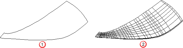

- Suppress internal lines on surfaces — Select this option to only draw the laterals and longitudinals:
- on the surface edges;
- in the direction where the surface is closed;
- along a discontinuity in a surface;
- on a single selected surface.
Deselect this option to draw all the laterals and longitudinals on the surfaces.
This option only applies to wireframe view.
Suppress internal lines on surfaces option is deselected.
Suppress internal lines on surfaces option is selected.

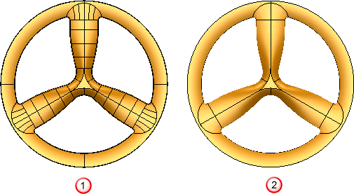

- Suppress internal lines on surfaces when shaded — This suppresses the drawing of internal lateral and longitudinal lines when shaded for clarity and efficiency.
Suppress internal lines on surfaces when shaded option is deselected.
Suppress internal lines on surfaces when shaded option is selected.

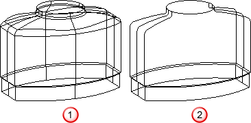

- Suppress internal lines on surfaces in solids
—This allows you to set whether you want the internal lines to be drawn on surfaces in solids. If selected, internal lines are not drawn.
- Suppress internal lines on surfaces in components
—This allows you to set whether you want the internal lines to be drawn on surfaces in components. If selected, internal lines are not drawn.
