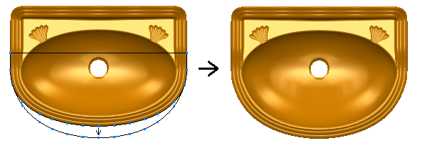

Morphing allows you to deform a group of surfaces into a different shape.
All the detail on the surfaces, such as fillets and trimming remain intact, even though the shape may be totally changed.

It can be controlled by using points, curves or surfaces around the model. For best results, use morphing to make minor modifications rather than substantial changes to the shape.
