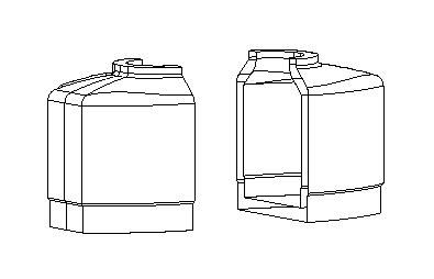

For example, the ink bottle model below has a vertical line applied to it:
Cutting along this line would produce the two pieces shown below:
The edges of the pieces along the cut are used to define section views.

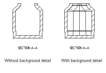

The section views below demonstrate the options to create views with or without background detail:
The line used to cut the model to define a section view, is called a section line.
You can have more than one sectional view on a drawing. To identify which section line belongs to a sectional view, a letter is placed at the top and bottom of the line and the sectional view has underneath it the word SECTION followed by the letters.
