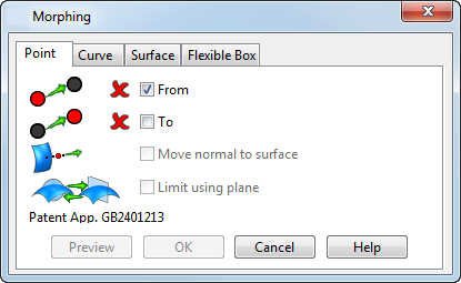

  1. Click the model or use the Position dialog to select the From point for the morphing process. This is the origin point that usually lies on the surface of the model. It is shown as a small blue circle.
    • In many cases, when you select the From point, a To (distortion) point is automatically chosen, indicated by a small red circle, and an initial bulge displayed.
    • If the selection you made for the From point does not automatically generate a bulge, the distortion point and the origin are in the same place.
  2. Select the To option and select or modify the distortion point that can lie anywhere in space, and is indicated by a small red circle.

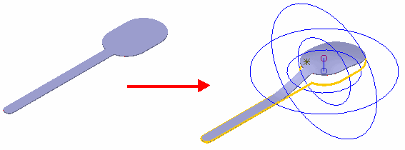

  3. Modify the size and shape of the distortion by using one of the following methods:
    • Drag the point to be modified.
    • Use the Morphing or Position dialog to change the position of the From and To points.

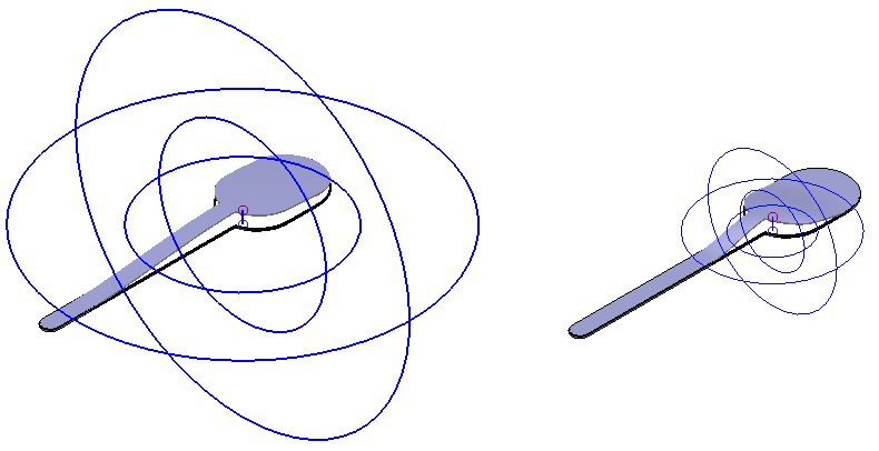

    • Use the two spheres to define the extent and shape of the bulge. You can change the bulge by using the mouse to drag a sphere. The graphics are updated when you release the mouse button.
      Altering the size of the outer sphere changes the extent of the morph a shown below:
    Altering the inner sphere affects the shape of the morph. Decreasing the size of the inner sphere makes the morph more angular; increasing the size of the inner sphere produces a more rounded bulge.
    To avoid introducing folds in the solid, the radius of the outer sphere should be at least twice the distance from the origin to the distortion point.

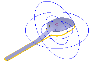

  5. Select the Limit using plane option to replace the bounding spheres with a limiting plane. The orientation of the plane is defined by the selected principle axis of the active workplane. You can drag the boundaries of the plane to adjust its position.
  6. Tip: This option is useful for altering the toe-spring of a shoe and similar applications where you want to bend a portion of a model. Select this option The model is bent so that the origin is moved to the distortion point. Points that are closer to the limiting plane are moved less and points at or beyond the limiting plane are not moved at all.
