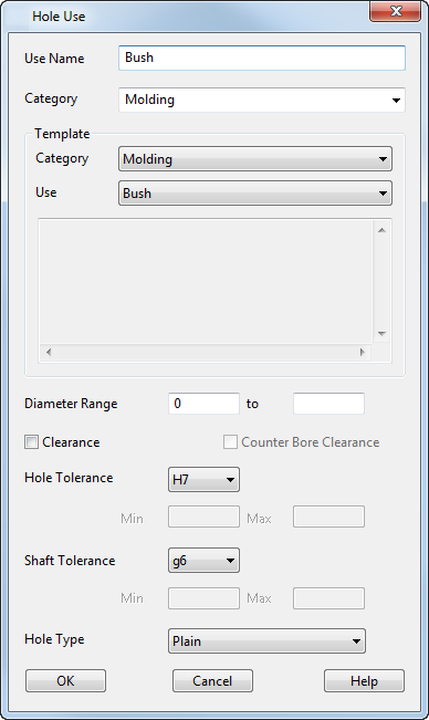

Hole Use dialog
This dialog is used to create and edit hole uses. It is displayed by clicking Create on the Holes page of the Options dialog.
  1. Enter a Name for the hole use. The name must not already exist within the selected category.
  2. Enter the name of a Category. You can select an existing category or enter in a new name.
  3. Define the Template using the Category and Use drop-down lists to select a hole use. This hole use is used specifies the values (mainly the tolerances) for the rest of the dialog.
  4. Change the settings on the remaining options to define the new hole use.
