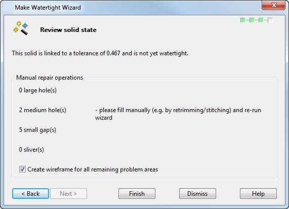

Review solid state page
Use this page to review the current state of the solid you are attempting to make watertight. The Manual repair operations panel indicates the current state of the solid and your previous manual repair (wireframe creation) choices.
Create wireframe for all remaining problem areas - Create a wireframe for each area of the solid where there is a problem.
Back — Return to the first page of the Make Watertight Wizard.
Finish — If the relevant option is selected, create wireframe for the selected problem areas and close the Make Watertight Wizard.
Dismiss — Close the Make Watertight Wizard without applying any changes.
