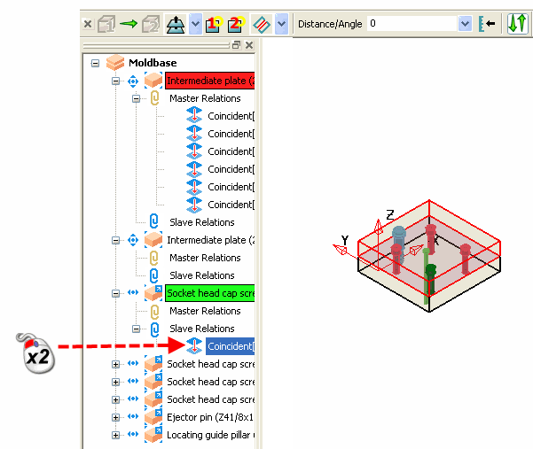

Use the following assembly tree shortcuts to quickly select and sort components, add components in free space, and modify relationships:

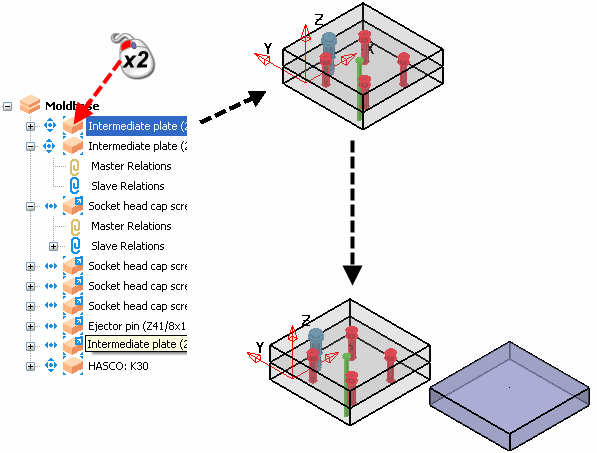

- Double-click the component icon. The cursor changes to
and the component graphics are displayed on the edge of the model window nearest to the cursor:

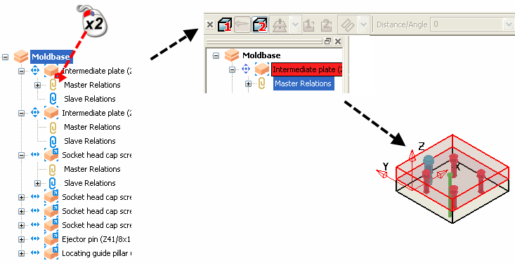

- Double-click the relation icon to start modifying the relationship:
- Double-click the relation branch icon of a component to start creating a relationship with the master and slave components selected:
- Select multiple items in the assembly tree by using Ctrl+Click or Shift+Click. You can select multiple:
