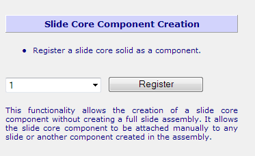

- Scroll down the page to the Slide Core Component Creation section.
- Select the name of the solid from the drop-down list.
- Click Register.
- You can now position the component.
