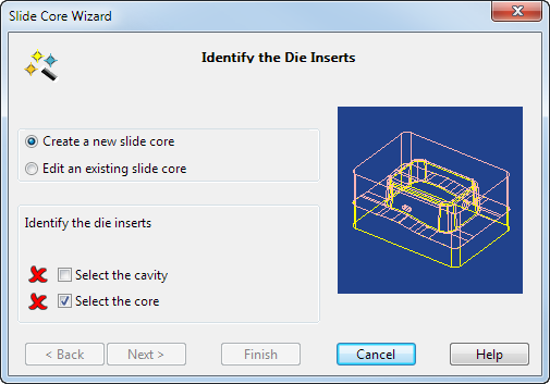

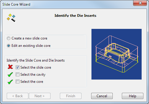

Use this page to select the die inserts for the core and cavity plates, using the following options:
You can select any two solids or components that are connected by a common face.
When you select non-single-instance components, the Multi-instance component selected dialog is displayed.
