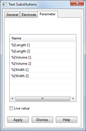

  3. Enter a label, if required.
  4. Click on the Text toolbar to display the Text Substitutions dialog.

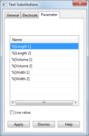

  5. Select the Parameter tab.
  6. Select the required substitution string.

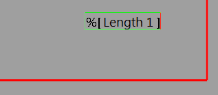

  7. Click Apply.
  8. Click Dismiss and click the drawing to display the substituted text.
