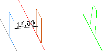

The reference is shown as a blue plane and the other plane shows the extent of the slide core. The dimension on the model shows the distance between the two planes.
