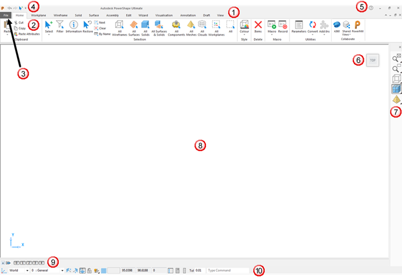

Screen layout
PowerShape uses a Windows-style interface consisting of a ribbon with tabs. The areas of the screen are identified as follows:
Tabs
Home tab
Note: See the Ribbon user interface topic for information on the tabs.
File tab — displays the Backstage View.
Quick Access Toolbar
Help menu
ViewCube
Views toolbar
Note: See the View tab > Navigate panel and View tab > Appearance panel topics for information on the Views toolbar.
Graphics area — Displays the modelling windows, in which you create objects and models.
Levels toolbar
Status bar
