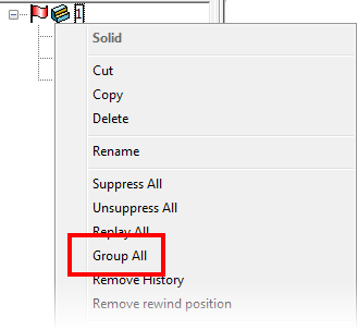

- Group features — Select this option to create a group of features when you:
- sequentially create five or more features of the same type.
- select individual features in the tree and select Group All from the Solid tree menu.
- select individual features on the model and select Group All from the Solid tree menu.

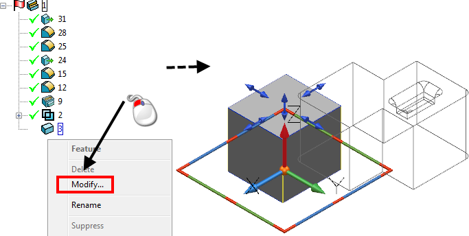

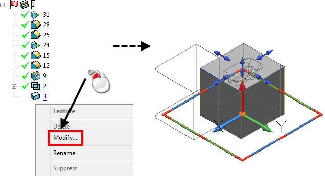

- Edit features in transformed positions — Select this option to edit a feature in its transformed position. So, if you have moved a Boolean block, the block is edited in the current position.
- If Edit features in transformed positions is deselected, the feature is edited in its position before the transform was applied. So, if you move a Boolean block, the block is edited in its original position.
This option currently works for the following features in the tree:
- base and primitive features
- Boolean features
- Boolean boss features
