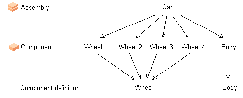

Assembly modelling allows you to quickly and easily generate complex assemblies of standard components. You can register solids as component definitions, and then create many instances of the component in an assembly. For example, a car can be an assembly consisting of four wheel components and one body component. Each wheel component is created from the same wheel component definition. The body component is created from the body component definition.

- Component definition — A mechanism for storing the geometry of a graphical object. The graphical object may be used to represent a complete engineering component, such as a car part.
Component definitions are automatically created when you create a component from a user-defined solid, a solid with Power Features, or when you add a component from a component library. When a component definition is created, it is stored invisibly. You can then use the definitions to create graphical components, and build the assembly.
- Component — Visible objects created from instances of component definitions, in particular positions and orientations in your model. A collection of components in an assembly is known as a
group, but groups do not define the assembly hierarchy.
- Assembly — A collection of components, which fit together according to specified relations. For example, in a car assembly, you can create four wheel components and a body component. The assembly also stores information on how these fit together to create the car:
