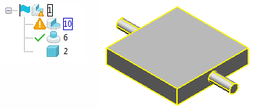

If a feature is no longer valid, it is suppressed from the solid and the
Error suppressed feature
icon appears next to it in the tree. For example, if you edit a cut feature and specify a depth that doesn't cut the solid, an
Error suppressed feature icon
appears.
You can click the
to find out why a feature is invalid.
Note: You cannot edit a suppressed feature, but you can edit an error suppressed one.

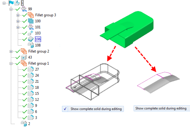

- Show complete solid during editing — Use this option to display the complete solid whilst editing a feature. This means that you can see the features that are further up the solid tree whilst you are editing a feature. This option is selected by default.
The example below shows the effect of using this option when editing the solid thicken
106.

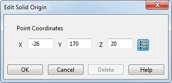

- Solid Origin — Select this option to display the
Edit Solid Origin dialog:
Use this dialog to define a reference point for a solid, to be used as a reference point during in grading.
