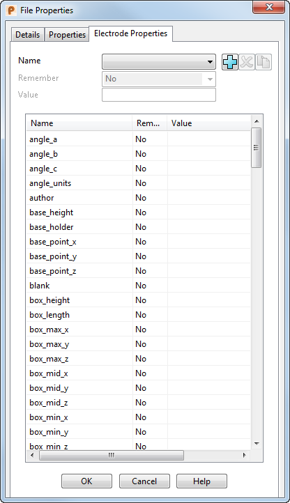

Use the Electrode Properties tab to create setup strings that can be used to add custom electrode text to a drawing.
You can enter information in this dialog so that it can be incorporated into text on your electrode model or drawing. You can also use some of the automatically generated information when you save a model.
Information in this dialog is used when adding an electrode substitution string to a drawing template.
Name — Enter the name of the property and click Enter. Other parameters now become available and the name is added to the property list.
— Click to add a property.
— Highlight a name in the list and click this button to remove a name from the list.
— Create a copy of the substitution string on the Windows clipboard.
Remember -— Select YesorNo from the drop down list. If you select Yes, the value for that property is automatically entered in the Additional Electrode Details dialog
Value — Enter an appropriate value. The property list is updated accordingly.
OK — Saves your changes and closes the dialog.
