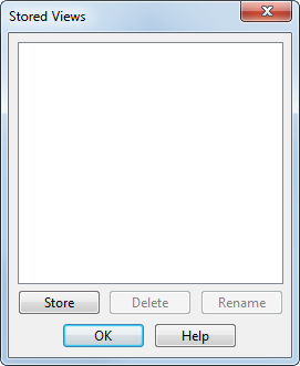

To create a custom view:
  1. Orientate your model to the view you want to store.
  2. Select View tab > Views panel > User > Store Views. The Stored Views dialog is displayed:
  3. Click Store. View 1 is added to the list.
  4. If you want to change the name of the view:
    1. Select its entry in the list.
    2. Click Rename.
    3. In the Rename Stored View dialog, enter a new name and click OK.
  5. Click OK to save your changes and close the Stored Views dialog,
To display a stored view, open the Stored Views dialog, and click the view you want to see.
