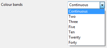

If Display errors to tolerance is deselected, select the required number of Colour bands from the list:

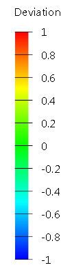

- Maximum value of error range — Enter a value into the field to define the maximum value of the error range. In the following example:
- Maximum value of error range is set 1.
- Colour bands are Continuous.
