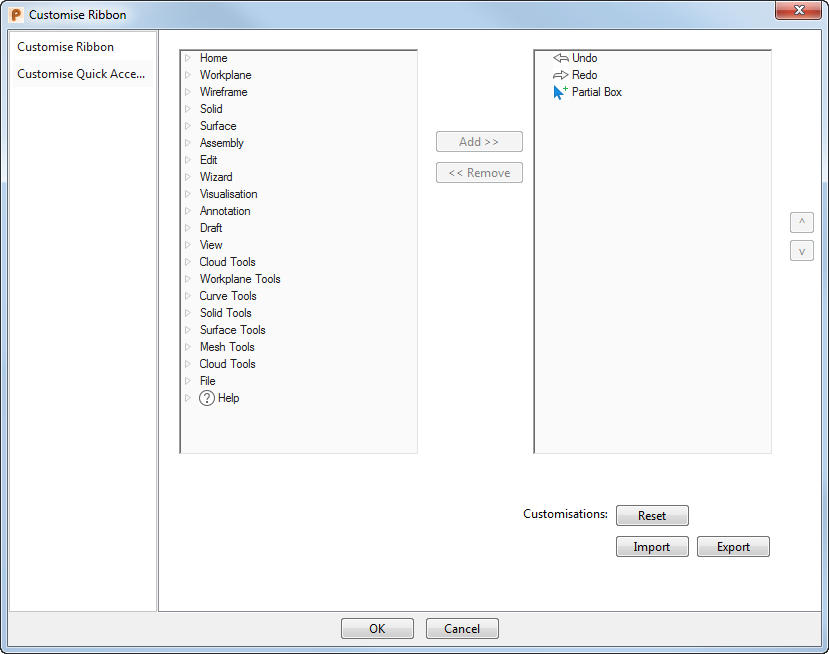

Customizing the Quick Access toolbar
You can use the Quick Access Toolbar page of the Customize Ribbon dialog to add and remove buttons from the Quick Access toolbar.
To display the Quick Access Toolbar page, right-click the ribbon or the Quick Access toolbar, and select Customize Quick Access Toolbar.
To add a button to the Quick Access toolbar:
  1. Select a tab, and then a panel, from the left list to display the buttons.
  2. Select the button you want to add to the Quick Access toolbar.
  3. Click Add to add the selected button.
Remove — Select a command in the list on the right and click this button to remove it from the Quick Access toolbar.
Reset — Click this button to reset Quick Access toolbar to default.
Import/Export — Click these buttons to import xml customization files, or to export the customized Quick Access toolbar as an xml file.
To move the Quick Access toolbar, right-click the ribbon or toolbar and select Show Quick Access Toolbar Below the Ribbon to place the Quick Access toolbar below the ribbon, or deselect it to place it above the ribbon.
