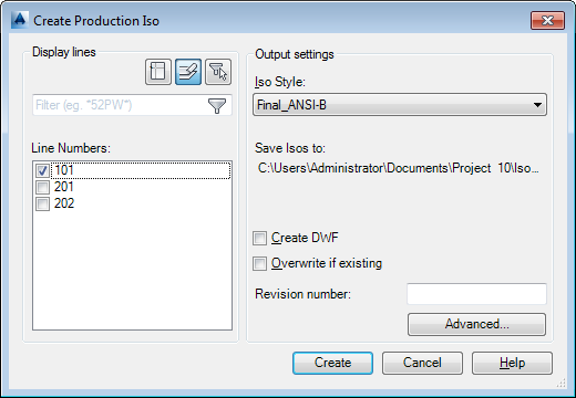

Create Production Iso Dialog Box
Creates a production isometric drawing. Specifies iso type, overwrite options, and DWF output.
Display Lines
Drawing
Lists line numbers that are in the drawing.
Project
Lists all line numbers in the project.
Filter
Lists line numbers in the current selection set.
Line Numbers
Sets the lines to include in the isometric drawing or PCF.
Right-click in the Line Numbers area to Select all lines or Clear all lines.
Output Settings
Specifies isometric output settings:
Iso Style
Specifies the Iso Style to use. You can create and modify Iso Styles in Project Setup.
Save Isos to
Specifies the folder where isometric drawings are created.
Create DWF
Specifies whether to create a DWF for the isometric.
Overwrite if Existing
If selected, existing isometric drawings with the same name are overwritten. If clear, new isometric drawings are renamed.
Revision Number
Sets the revision number which can display in the title block.
Advanced
Displays the Advanced Iso Creation Options dialog box.
Note: When Create is selected, a progress bar displays at the bottom of the dialog box, showing details of the iso creation.
